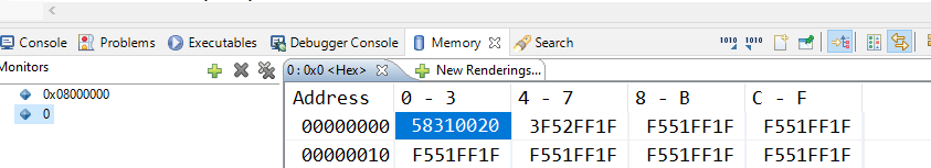

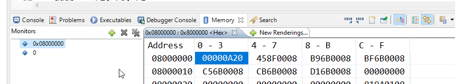

This is flash content. This is the vector table. First Stack-Pointer, Second: Reset-Vector
This is the memory content at 0, should have been exactly the same as 0x08000000. but it isn't. Reset Vector points to 0x1FFF51F5 (obviously bootloader code)
But Memory-Remap-Register shows zero. Flash should be remapped to zero.

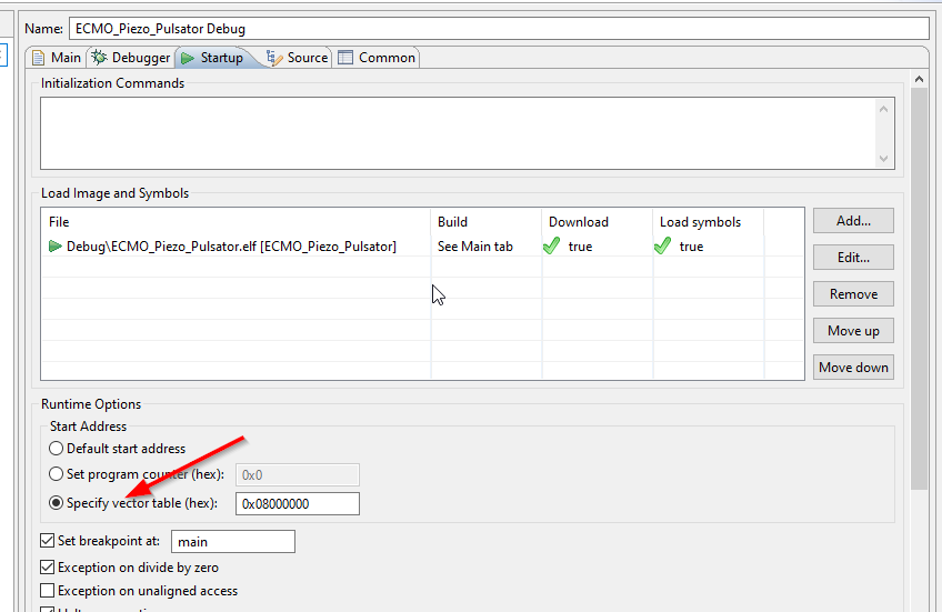

2021-06-15 7:48 AM
By the way: Playing with this setting does not do anything.
