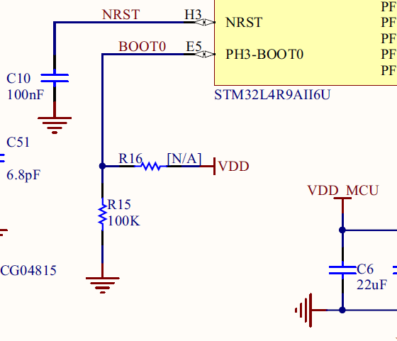

> PH3-BOOT0 pin pulled to ground with 10k Ohm resistor
That means, you're already suspecting this is bootloader entry, and so do I.
Check for bad solder joints and shorts. Decrease the value of that resistor.
2021-06-09 3:02 PM
Hey JW,
Thanks for your reply! PH3-BOOT0 was my first suspicion but this project was originally created and running in Keil uVision IDE before being ported to CubeIDE a year ago. I don't recall seeing this issue in Keil before, but it may have just gone unnoticed or maybe Keil handled it differently.
Based on your response, are you stating that PH3-BOOT0 is still read to determine the application start address even when using the debugger in CubeIDE?
Edit:
Looking at the STM32L4R9I-DISCO devkit from which this project was based on, it appears PH3-BOOT0 is pulled to ground with a 100K ohm resistor.
Thanks,
Derek

What I meant with decreasing the resistor value is, that would there be some conductive debris around given pin/tracks (soldering residui for example), this would help. Resoldering the pin to exclude bad soldere joint, decreasing the resistor (even to zero if you don't use the pin otherwise) and cleaning the surroundings is a quick task and would never harm.
You don't jump into the bootloader deliberately anywhere in your program, do you?
This of course still can be also something else, e.g. software error ending up by coincidence in the bootloader area.
You should also review all possible bootloader entry methods as per AN2606, and if there's any chance to avoid some (e.g. by setting some of the option bits), try to use them.

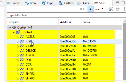

2021-06-15 4:05 AM
I have a similar problem. I found out, that the debugger obviously does not set the Vector Table correctly
I case of a non running debug session, I can halt the CPU and look at CPU register "VTOR", which stores the Vector table address.
Here: VTOR points to 0x1FFF0000
Now we need to know, how to encourage the debugger to set VTOR correctly every time. ...
