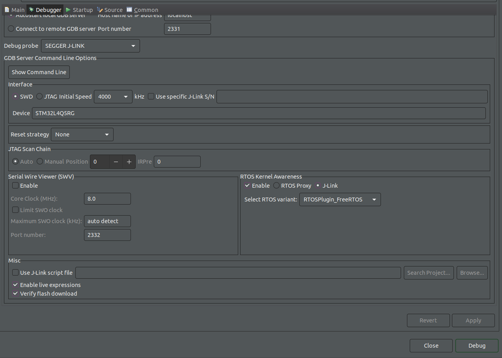

I'm not a J-Link expert so if nobody is able to help you here then perhaps you would need to use the Segger forums. However, it looks like you might be using "Run" and not "Debug"? Possibly the -s command that activates the 'singlerun' option?
2022-04-06 12:21 AM
Another question. Which OS are you running on when encountering this issue?
2022-04-08 10:03 PM
Hi Markus,
Thanks so much for getting back. I deliberately changed the mode in my project settings to Debug mode and the result remained the same.
Could you advise where I might be able to remove the -s switch? I attach a screenshot of my J-Link settings.
Thanks,
Ed
2022-04-08 10:05 PM
This is Ubuntu 20.04.4 LTS. I tried using in Windows 11 and it worked without problems.
Thanks,
Ed
