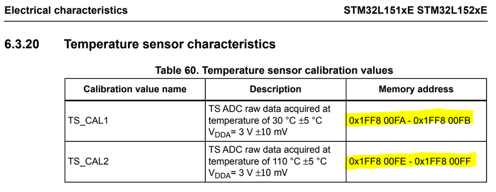

TDK
Super User
Looks like the addresses it uses are not consistent with the user manual. Use STM32CubeProgrammer to verify the CAL factors are nonzero in memory in the datasheet locations.
TDK
Super User
> In stm32l152xba.h
> The micro in use is an STM32L152RET6
That's not the correct include file for that chip.
The addresses in the current CMSIS include file stm32l152xe.h match those of the datasheet.
https://github.com/STMicroelectronics/STM32CubeL1/blob/master/Drivers/CMSIS/Device/ST/STM32L1xx/Include/stm32l152xe.h#L851
