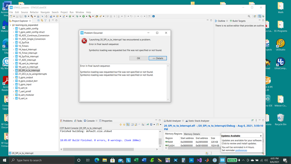

I have a nasty problem with my STM32 Cube IDE on one machine. I had moved the working folder using the Export from STM32 CubeIDE in one machine to another where I used the import tool as I followed the info from STM on the web on how to do this. Although everything seems to compile OK on the other machine when I go to load the file through the debugger I get an error "Symbolics loading was requested but the file was not specified or not found". This is happening with every project file in the workspace. I have gone over the project build properties and debug properties and cannot find an answer or solution to this problem . (see attached screen capture)
Any help will be greatly appreciated.....Thank you.

A3: After a successful compilation I opened the debugger and the debugger started its process (the ST-link was already installed and the board was recognized). Towards the end of the initial debug process I got the error showing me "Symbolics loading was requested but the file was not specified or not found"
As far as I know I did not create a new or different debug configuration.

Looks to be some breakage in the debug settings from one version to the other. Try to create a new debug configuration and verify correct project and correct path to the "elf"-file in the "Load list" (Startup tab in debug settings).

project-> properties-> Run / Debug settings
-> edit
-> c / c ++ Application
I was able to resolve the error by setting the correct elf file in the above setting items.

If you have debug configurations in the project, do not reuse them after import.
Delete the debug configurations and create new.
