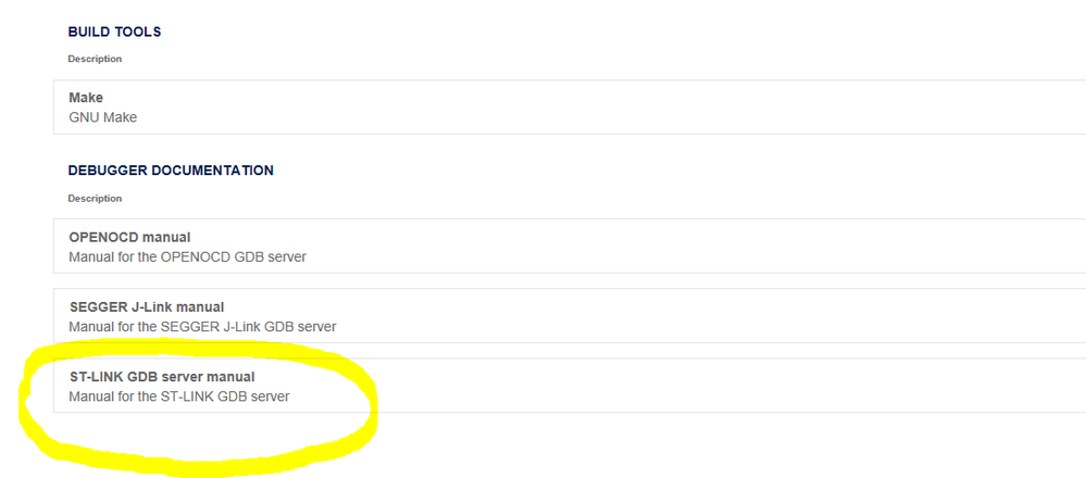

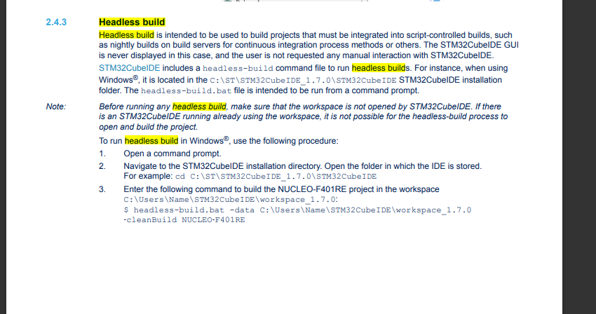

2023-01-04 10:25 PM
Hi @Wijeden RHIMI ,
Please point me to the help info center to find the user guides. I could just find the normal STMCudeIDE user guide.
I need to find the GDB user guides as well as the headless user guides.
2023-01-05 1:28 AM
Hello@VNaga.2,
Maybe those two screenshots bellow could help you :
Don't hesitate to ask any additional questions .
Wijeden,
