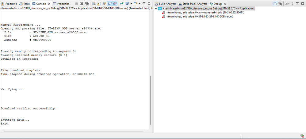

When i run my code, something wrong with the gdb (like in the picture). Someone can help me pls?

It is a normal behaviour when making run. If download is verified successfully, GDB session will be terminated that's why you see "terminated arm-none-eabi-gdb" in the debug window.

What's in the console?
2023-01-02 1:47 AM
It says download successfully, is it run properly or not (with terminated arm-none-eabi-gdb)??

Hello BAl K.1 ,
At first , let me thank you for reporting your issue.
Could you please supply the gdb server log-file? It will be created if option “Log to file�? is enabled in the debug settings.
Regards,
Rim

Are you sure you are using the right debug button looks like you are using the run button?
2023-01-03 9:39 AM
Yes, i use run button, i want to run the code and that error appearing. is there any solution for that??
2023-01-05 2:18 AM
