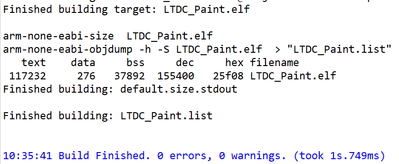

Hello TDK
The Example I use LTDC_Paint is not a MX made project, I was hoping there is a way to import the project into workspace, so that a copy of the project will actually reside under workspace 2.0.0 folder.
When I import a project, I tried selecting "Copy to workspace", but this project then does not want to build, I think a lot of middleware is not copied.
I then resort to keeping a copy of the project inside STM32Cube_FW_F4_V1.28.0 itself.
Not sure if this is the right way, but it works.

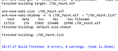

Hello TDK
