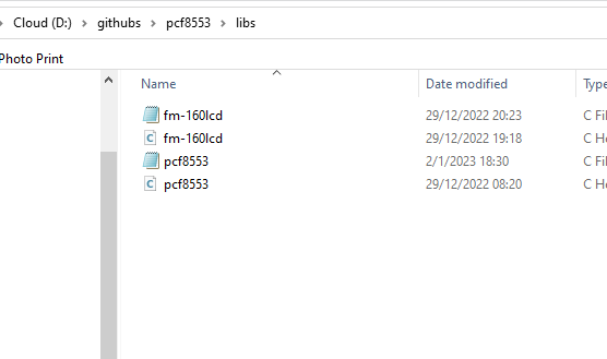

I developed some libs to control a custom LCD.
At the beginning the workspace only had one project, 01_main, and files related to my lcd and driver were located there, later I started another project 02_rtos, so I copied LCD files into new project.

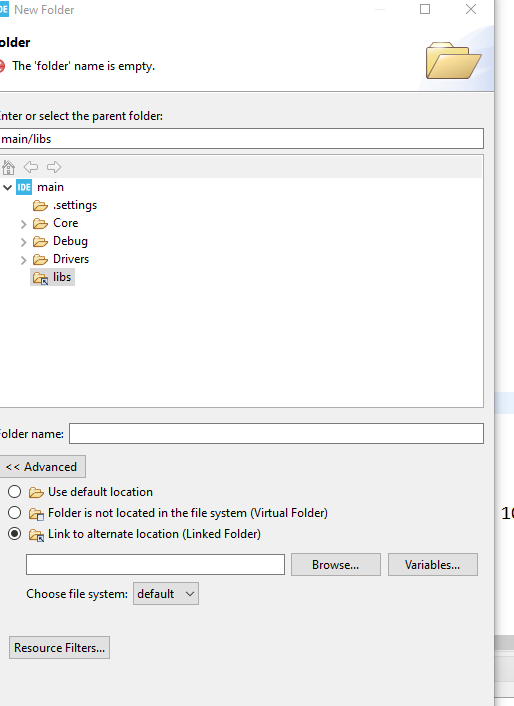

I need to create more projects, libs could be modified from any project, so I create the lib folder, it has the only version of my files, I created this folder with "Link to alternate location"
Everything is working but, My questions:
Is this approach ok? or Is should do something else, please note a want to keep workspace on GitHub, this modify in some way the folder organization approach?
If it works for you with git, why not.
The "libs" folder can be converted to a git submodule, so it can be shared among other repos/projects.
Other version management systems such as Perforce, Synergy, Clearcase have a different way to maintain and track common files.

Hello dhs,
There are at least two approaches to share libs between projects:
1- Share the lib with the project and Link to alternate location created (as you did)
2- Create a static library project. It takes some setup time, but after that it's a more efficient way to manage.
Thanks,
Rim
