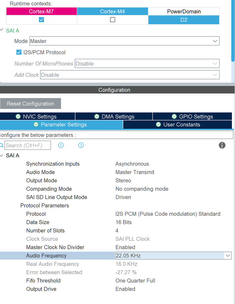

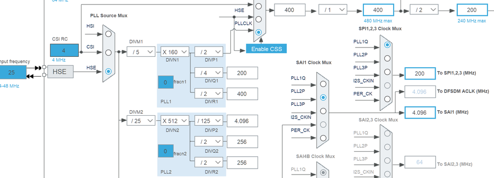

So - the clock for SAI is set to 4.096MHz. I use SAI1 configured as on the screen:
0693W00000WLEAFQA5.png0693W00000WLEAKQA5.png0693W00000WLEAPQA5.pngHere's my code:

What am I doing wrong? My goal is to see a sine wave on one (or best both) speaker outputs. As the WM8994 driver passes initialization, I suspect the SAI doesn't work at all. Or IDK, am I missing something about PCM data? I assumed it's just samples, each 16-bits with sign. But then again, if I messed up the data, but still provided changing values - there should be at least something on the scope. But running the code does absolutely nothing.

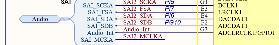

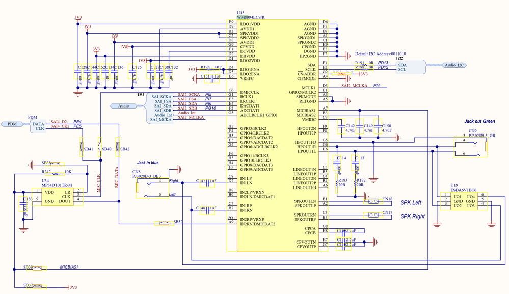

Now wait a minute, I have SAI1 in example, but the board schematics says otherwise:
0693W00000WLEpSQAX.pngI tested it with SAI2, but still, the same, doesn't work.

+ SAI clock is so slow - why ? ( i use 96 MHz sai module clock )

I changed the configuration to SAI2 Block A. Pins match the schematics. Where can I set clkout A?
I'm trying to recreate this example on STM32CubeIDE project.
From what I see in the board schematics - the WM8994 is connected to SAI2 not SAI1:
