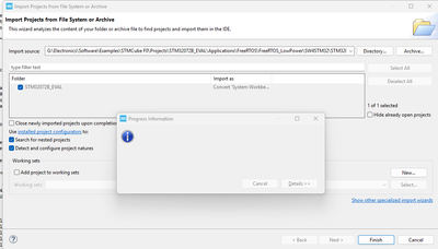

A couple of weeks ago STM32Cube disappeared off my computer. I went a got the install file for the most recent version (2.1.1). Since I have installed this when I try to import an old project into the workspace or use MX to generate code when trying to configure the pin outs to start a new project it keep trying to import lots of additional projects giving prompts that the project is old, it will be removed the new version will be installed. It then tries to import the STM32072B_EVAL project and hangs up.

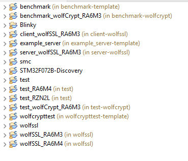

These are the imported projects, none of these are the project I'm trying to import.
This is when it hangs.
