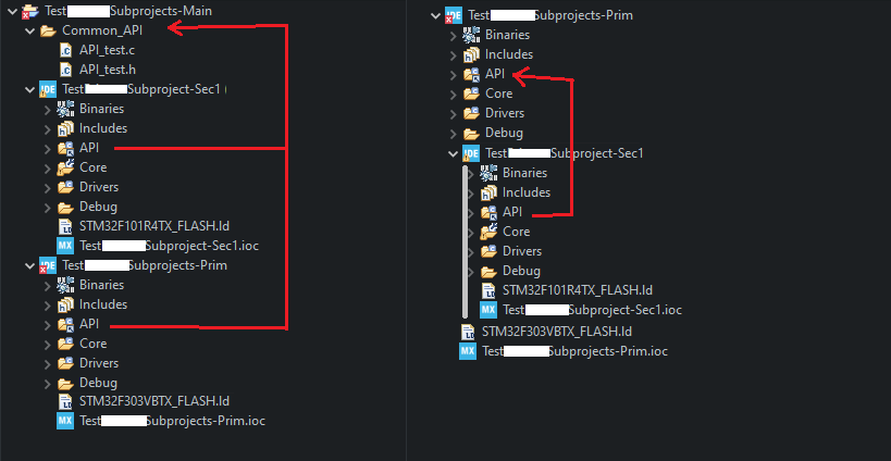

The context is the following : I have a device including 2 micro-controller, 1x STM32F303 and 1x STM32F101. The F303 communicates with the serial bootloader input of the F101 through an isolation barrier as safety requirement. The goal is to bootload the F303 using STM32Cubeprogrammer and let it update the F101 at next power on.
What I need is to create a project that allows to debug both uC (ideally at the same time). So far its easy. But I also need to include the image of the F101 uC inside the image of the F303 uC to allow the update mechanism mentionned above. This should ideally by transparent for the devs once configured to avoid human errors : building the F303 project should trigger a build of the F101 as pre-build step before building the F303 image that include it.
I feel like I need to have either a master project including both or a nested project. Attached the structure I obtained trying both options. Arrows represent folder links to the shared part of the code. Any advice on one or another is welcome.

1)
Go into project properties -> Project References in the F3 project and select the F1 project. That will cause the F1 project to be built before.
2)
One way would be to convert both outputs to BIN files, then combine them. You would need to leave room for the second BIN file and pad accordingly.
I don't see how debugging both projects at once would be possible.
