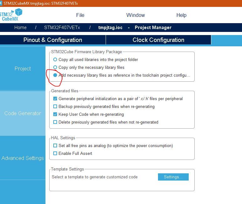

I'd experimented with that and STM32CubeMX generated paths like these in the (IAR) project file:
<state>C:/Users/alister/STM32Cube/Repository/STM32Cube_FW_F7_V1.14.0/Drivers/STM32F7xx_HAL_Driver/Inc</state>
...The problem here is that other developers cloning or pulling the repository would have different user names.
If you've been here, what was your fix to this?
Thanks
Alister
2019-02-14 4:50 PM
I've experimented just now changing STM32CubeMX's Firmware Location to point to the root of my software tree, where I already have the Drivers and Middlewares directories and want them to remain.
STM32CubeMX displays the path as absolute. But on generate, I see it's saved the path as relative, which is promising.
E.g. in the .ioc:
ProjectManager.CustomerFirmwarePackage=..\\..\\..\\..\\..And in the .ewp (IAR project):
<state>$PROJ_DIR$/../../../../../../Drivers/STM32F7xx_HAL_Driver/Inc</state>
