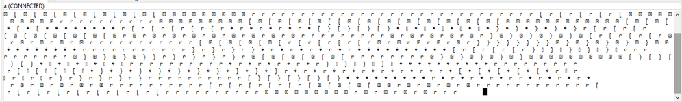

}From console:
Also, it looks like program exits print _to_console() after 4th iteration (i=3) and goes to the int main () to while(1).

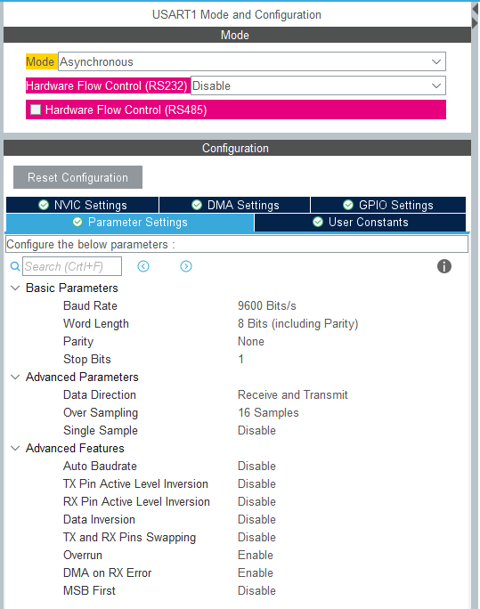

USART1 configuration (same configuration in the console):

Data Representation 101
The data in the array is in binary form used by the computer, if you want human readable ASCII decimal characters use sprintf(str,"%d". ..) or itoa()
2022-01-05 5:15 PM
In addition, use strlen instead of sizeof to avoid sending a null character (or more), at the end of each transmission.
