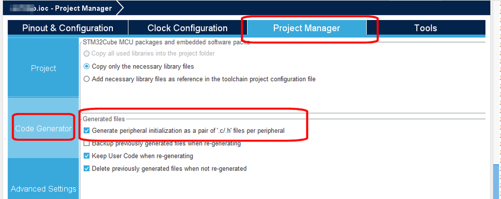

@EvO wrote:the issue we are running into is that the integration of all hardware initialisation in the main.c file is different from the existing code: libraries with hardware interaction have all platform-specific code in separate c/h files
You can configure CubeMX to generate separate .c/.h files:

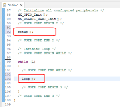

If you're familiar with the Arduino setup() and loop() structure for your user code, that can easily be achieved in the Cube-generated structure as:
That way, you can leave all the generated code alone - much as you never see Arduino's main() - and just work in your own files with your setup() and loop() functions ...

Thank you Andrew, that really helps. Especially the Code Generator bit. I will still have to duplicate some boiler plate code between projects, but at least there will be specific places where to put the wrappers. This should be the default IMHO.
I wasn't after replicating anything arduino-like and the setup / while(1) structure is already in the STM main.c, so that was good enough for me, as those are are only calling a single function each in my case. Also I wasn't after using ArduinoIDE to manage the STM projects (and miss out on debugging).
