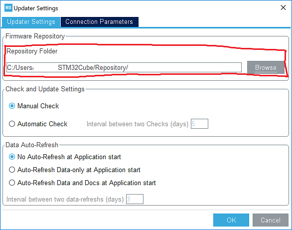

In STM32CubeMX, you can navigate to Help -> Updater Settings to change the repository directory. I don't know if this will carry over to STM32CubeIDE, but it may.

thanks
I changed that but it did't help

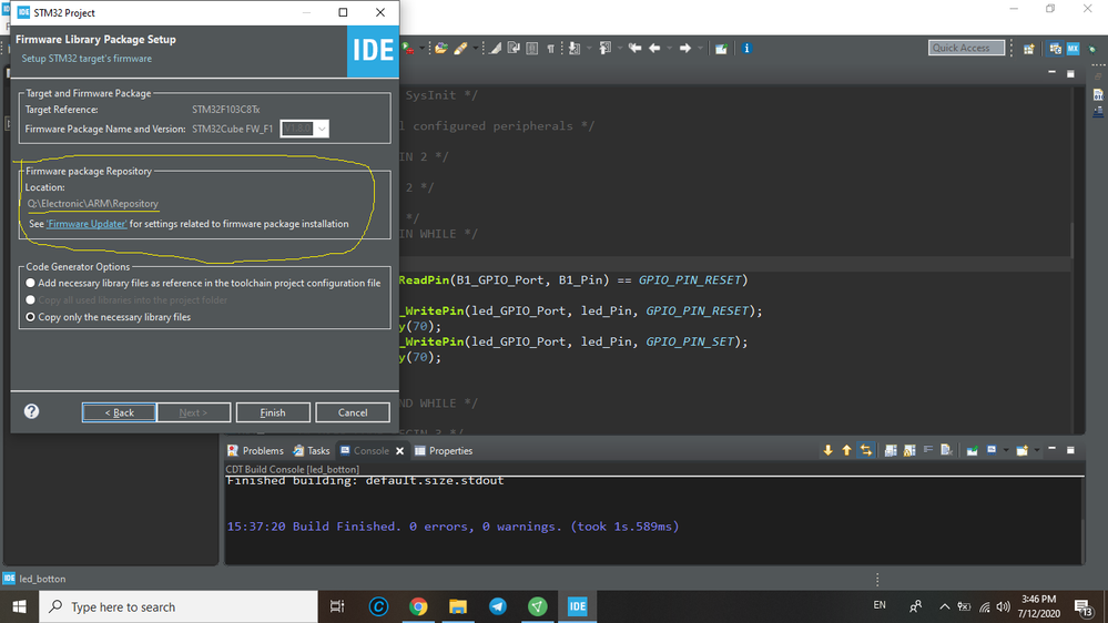

i find a way to change "Firmware package repository" in CubeIDE when creating project and still nothing

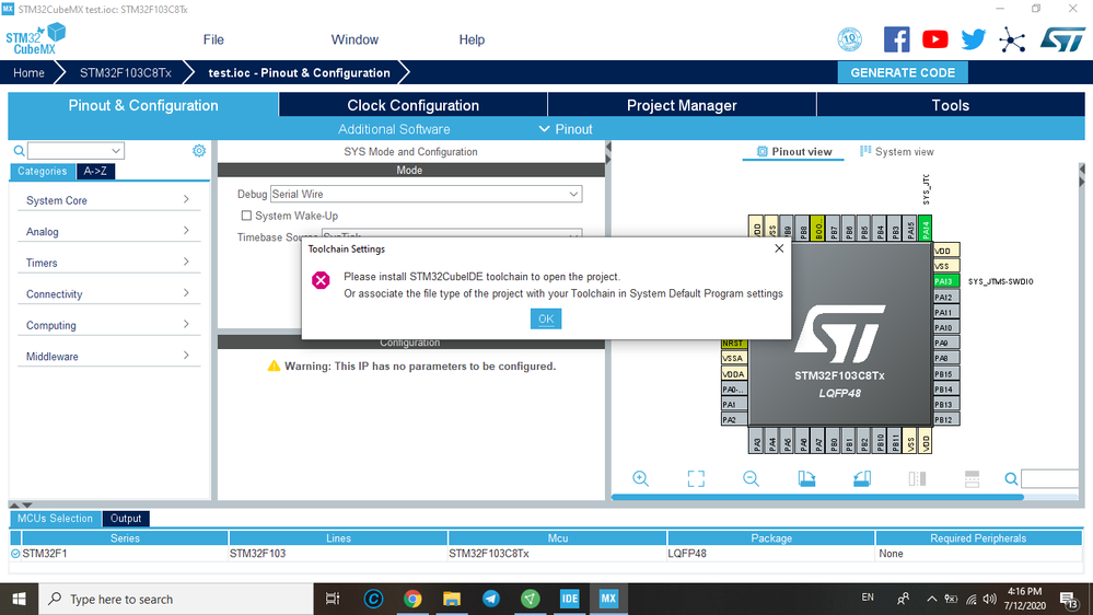

another thing: when i'm trying to create the project from standalone CubeMX, this error pops up, thank you very much!
and I have installed the CubeIDE!
i'm not sure what i'm doing wrong...
2021-01-26 12:09 PM
Very late answer (sorry about that), but it might be helpful for future readers.
In STM32CubeIDE, look at the menu bar at the top, and go to Window, Preferences, STM32Cube, Firmware Updater. In the upper portion of the window you should find a field named Firmware installation repository.
