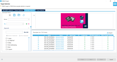

Hello @naveenchandran
To find the sample programs using the STM32CubeIDE, you should select File > New > STM32 Project:
Then, go to the Example selector:

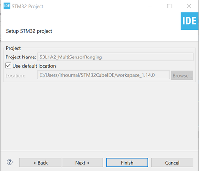

Select the example you are locking for and click on next then finish (after choosing Name and location if you want):
