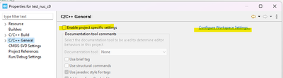

2024-01-20 9:51 AM
This can be related to inheritance of project settings from the workspace settings.

Thank you for your suggestion. It sounds reasonable, but I can't find anything related to incremental build in the workspace settings. I have checked all workspace settings related to build and automate.
The problem is solved if in the settings
Project Properties => C/C++ Build => Behavior => Build: (Incremental build)
I just change Enabled to Disabled and back to Enabled. Meanwhile, I don't do anything with the workspace settings. So probably the workspace settings do not affect this problem.
