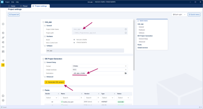

As a workaround, I suggest editing the Destination before generating the new project to update the source code path to the new location and avoid this issue.
