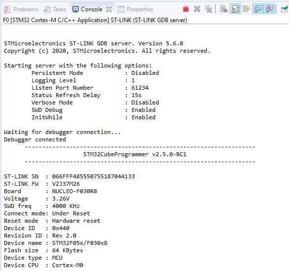

2020-08-04 1:32 PM
@PEnright
C:\Program Files\STMicroelectronics\STM32Cube\STM32CubeProgrammer\bin\STM32CubeProgrammer.exe is STM32CubeProgrammer standalone product having its own UI.
If STM32CubeIDE usage relying on "debug as" CubeProgrammer may be (depends on selected probe) used too but possibly not same binary (depends on which product releases you're relying on). Fact is STM32CubeIDE is embedding its own Cubeprogrammer.

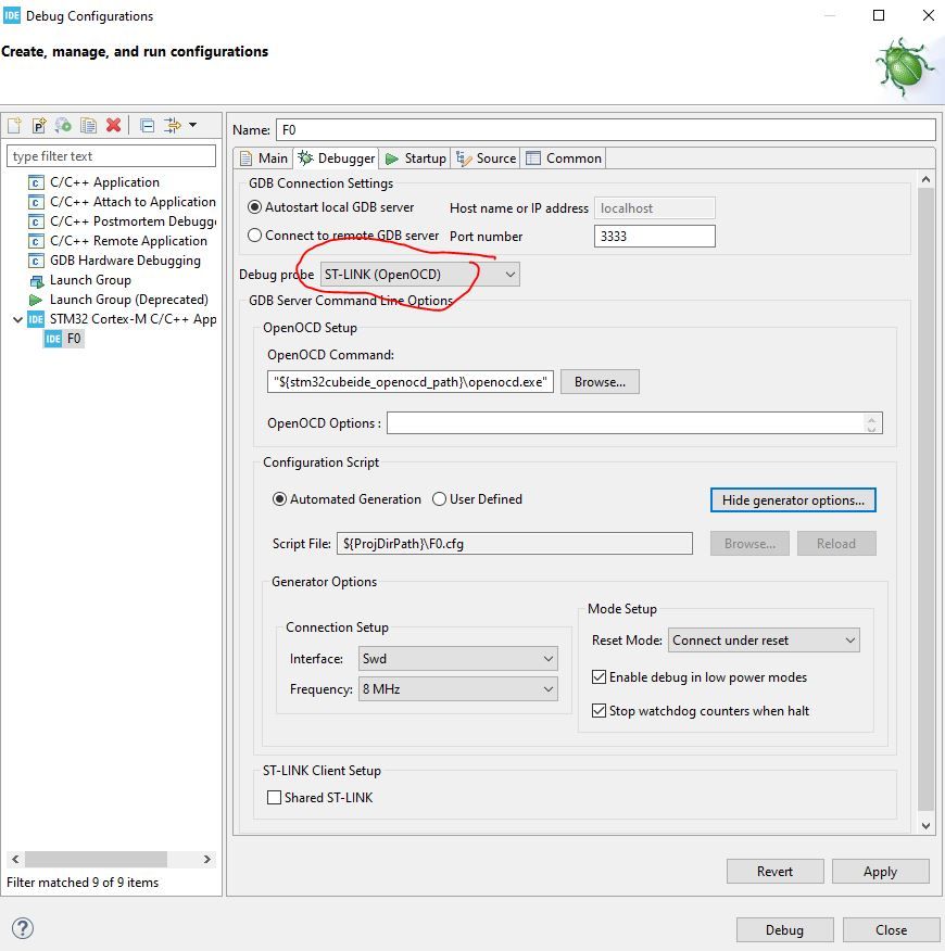

2020-08-04 1:38 PM
Have a try based on OpenOCD usage too ... CubeProgrammer usage is skipped here.
