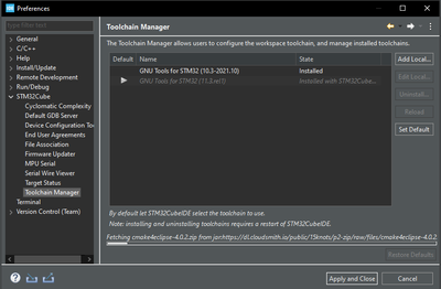

Since the latest release many have faced compilation errors after migrating to the 1.13.x which contains GCC 11 as default toolchain.
Short term solution:
Under Window>Preferences>STM32Cube>Toolchain manager install the GNU Tools for STM32 (10.3-2021.10)

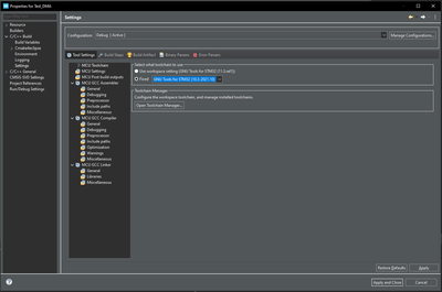

Under the project properties C/C++ Build>MCU Toolchain set the toolchain for the selected project to the GNU Tools for STM32 (10.3-2021.10)
