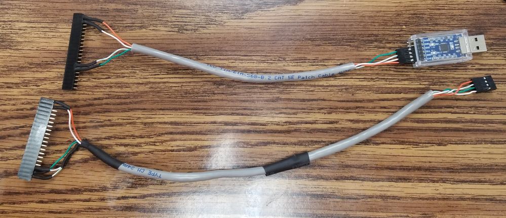

@Jorge Jacome did you get anything to work on the Blue Pill?
I am currently having something similar, if not I can start a new thread.
I am testing three different Blue Pills and a Nucleo-64. I am new and have been getting inconsistent results. I started with CubeIDE 1.3.(something) and it has now upgraded to 1.4.1. Right now I don't see any differances between the two versions concerning flashing.
First I was trying to use the Nucleo-64's STLink and it will not power up the target. I guess that question will be for another thread. I was able to flash one of the Blue Pills using the serial (Boot0) and the CubeIDE did upgrade the STLink software. So that leaves me with two target boards.
I can connect to both with Demonstrator GUI - serial (Boot0). I have wipe both memory without seeing any errors.
I can connect to one with the STLink software but not the other. While connected with the STLink software I can do all functions to the target, including loading the hex file built by the CubeIDE.
The call confidence tests, because you know what expected results are. I am new to this, so I not sure if I am doing it wrong, software configured wrong, hardware wrong, etc... I did make a jig for the blue pills to help make my tests more repeatable.
