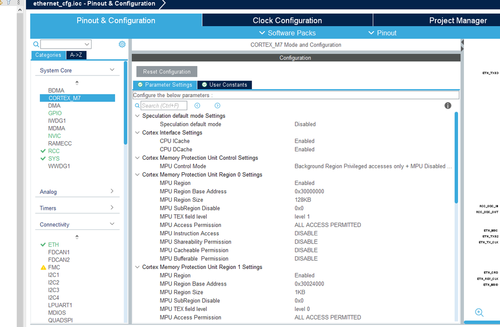

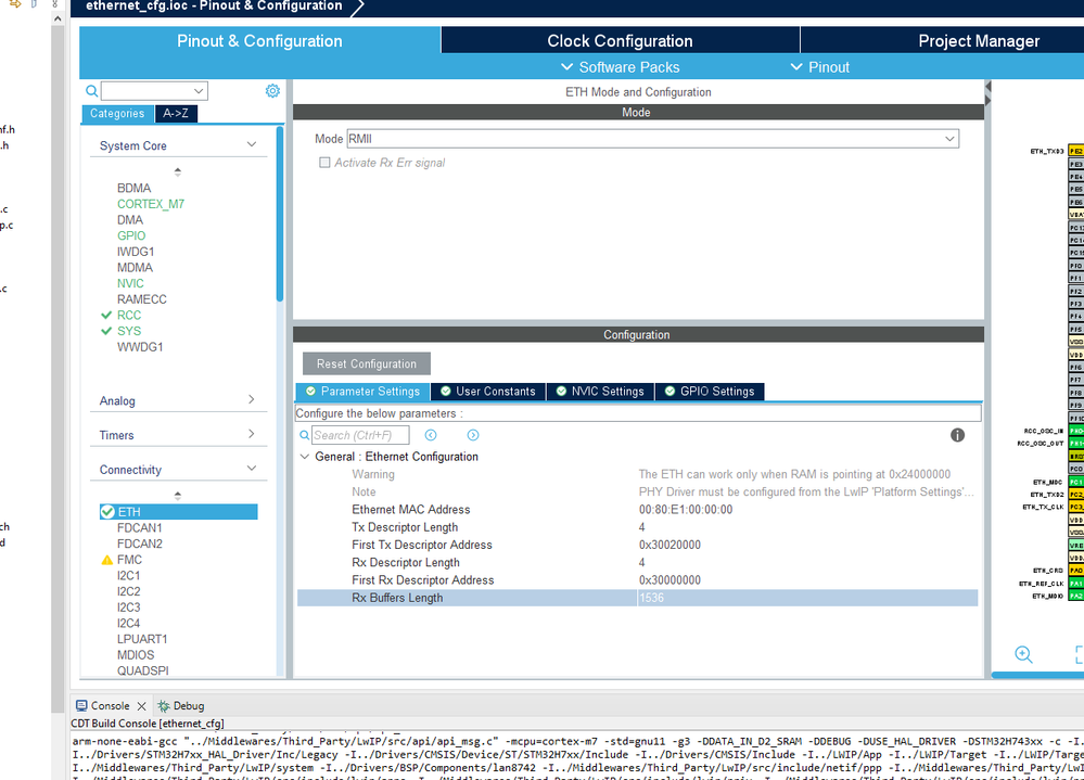

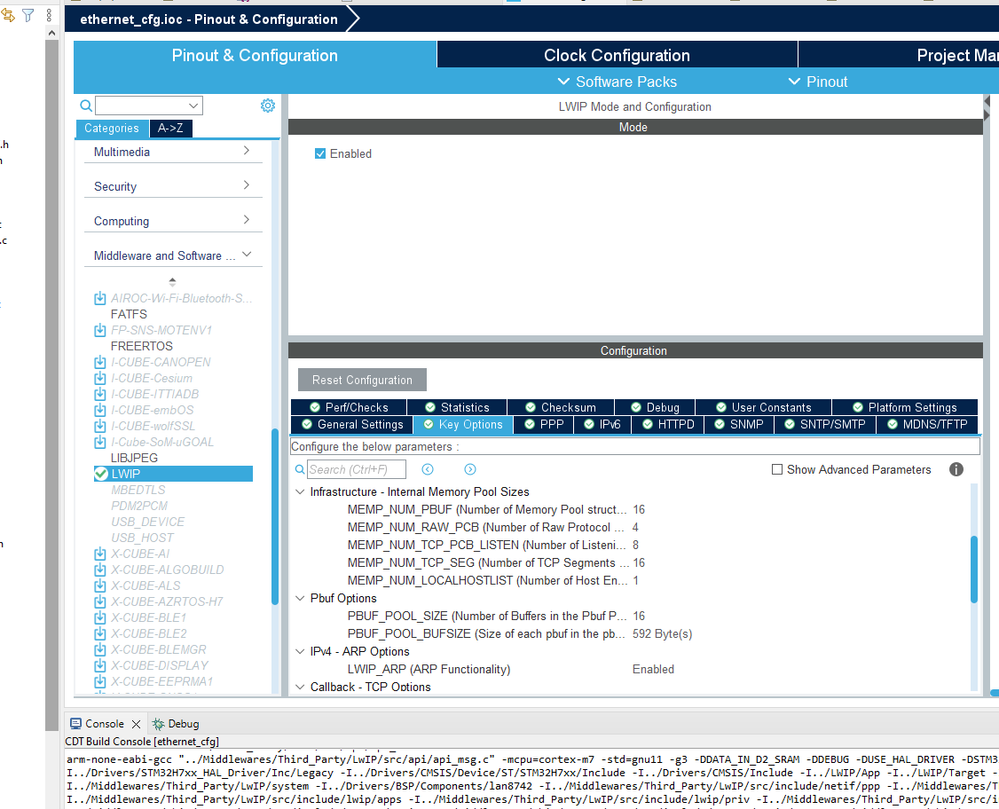

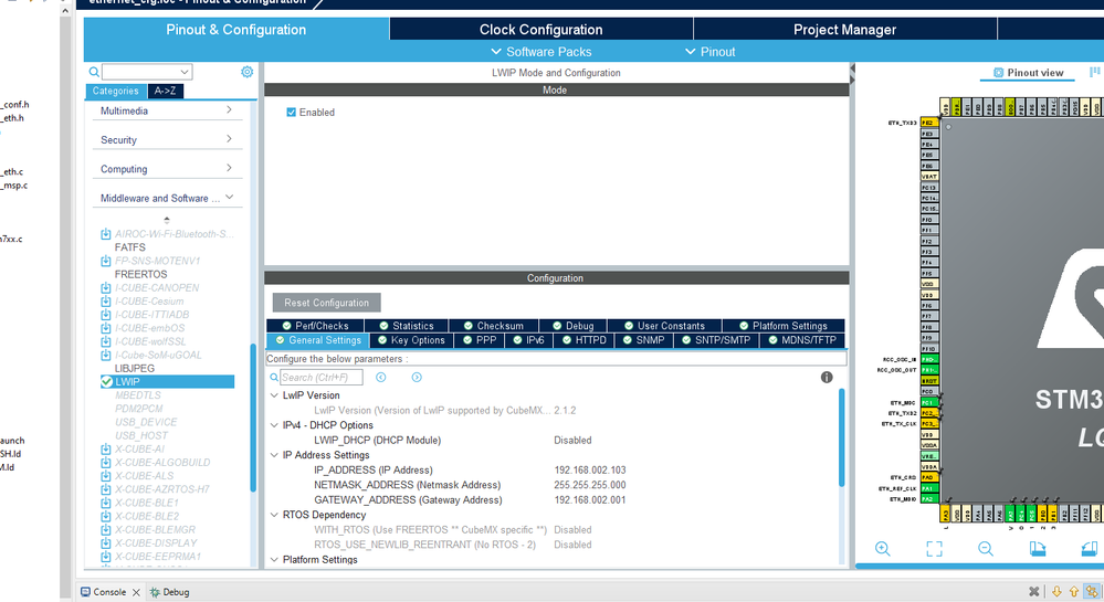

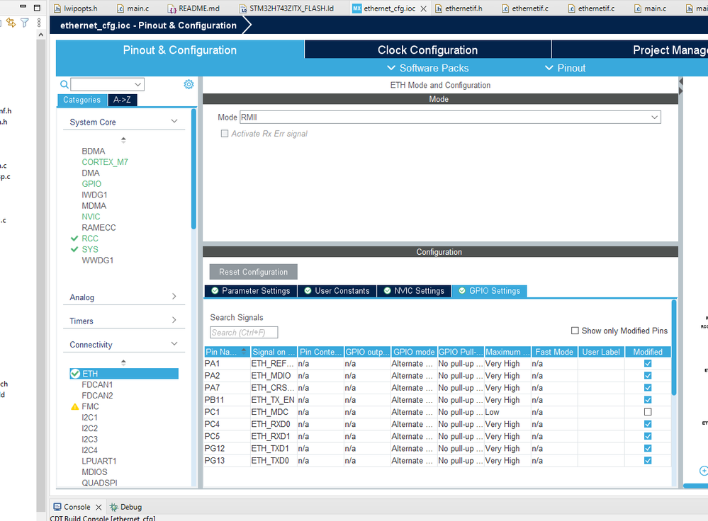

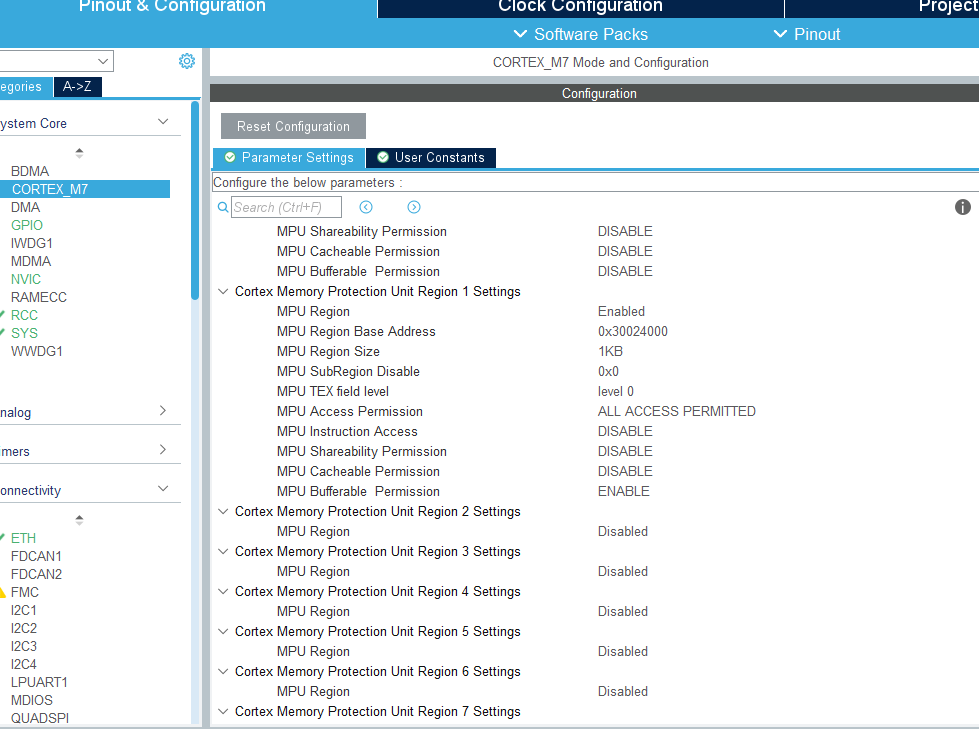

2023-11-22 7:08 AM
2023-11-22 7:11 AM
Please find thje above settings I did in cubeide. I called ethernetif_input() in main and trying to ping the IP addresss.The ethernet connection is not established . I am getting error like host is unreachable. I tried all possible configuration of MCU, LWIP, ethernet settings from my side. Could You please guide me with correct settings
