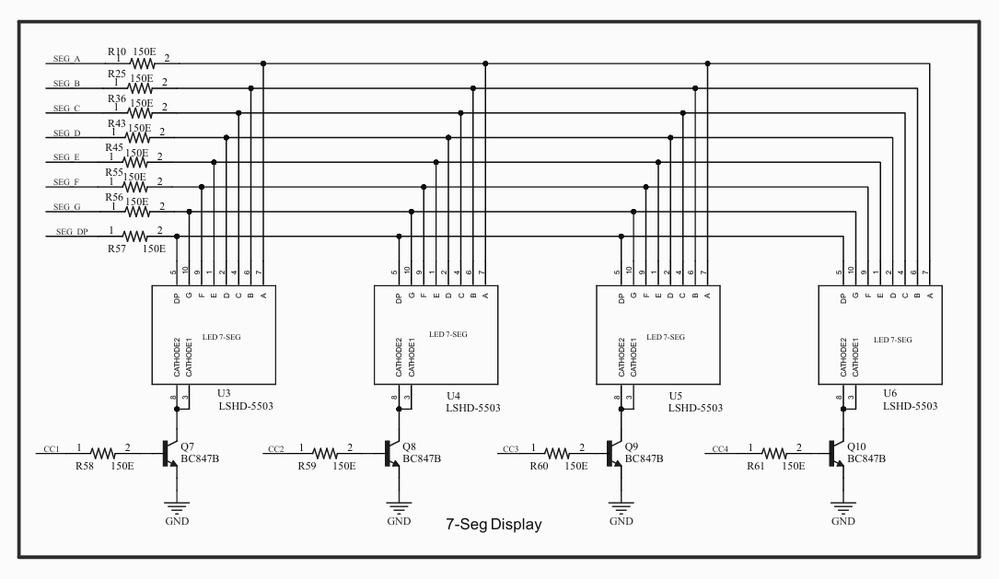

2024-08-21 11:07 PM
Thanks for your reply
I have 4 PNP-Transistor which i connect to the 7 segment in order to drive it. I created one schematic which I connected here.
You can check
Thanks

const uint8_t segments[] = {
0b00111111, // 0
0b00000110, // 1
0b01011011, // 2
0b01001111, // 3
0b01100110, // 4
0b01101101, // 5
0b01111101, // 6
0b00000111, // 7
0b01111111, // 8
0b01101111 // 9
// Array to hold digit values for the display
uint8_t segment_bits[4];
segment_bits[0] = segments[digit1];
segment_bits[1] = segments[digit2];
segment_bits[2] = segments[digit3];
segment_bits[3] = segments[digit4];
// Time to display each digit
const uint32_t digit_delay = 2; // Time in milliseconds for displaying each digit
const uint32_t total_display_time = digit_delay * NUM_DIGITS;
uint32_t start_time = HAL_GetTick();
uint8_t current_digit = 0;
while (HAL_GetTick() - start_time < total_display_time) {
// Turn off all digits
TurnOffAllDigits();
// Turn on the current digit
switch (current_digit) {
case 0: HAL_GPIO_WritePin(DIGIT1_PORT, DIGIT1_PIN, GPIO_PIN_RESET); break;
case 1: HAL_GPIO_WritePin(DIGIT2_PORT, DIGIT2_PIN, GPIO_PIN_RESET); break;
case 2: HAL_GPIO_WritePin(DIGIT3_PORT, DIGIT3_PIN, GPIO_PIN_RESET); break;
case 3: HAL_GPIO_WritePin(DIGIT4_PORT, DIGIT4_PIN, GPIO_PIN_RESET); break;
// Set segment values based on current digit
uint8_t bits = segment_bits[current_digit];
set_segment(SEG_A_PORT, SEG_A_PIN, !(bits & 0x01));
set_segment(SEG_B_PORT, SEG_B_PIN, !(bits & 0x02));
set_segment(SEG_C_PORT, SEG_C_PIN, !(bits & 0x04));
set_segment(SEG_D_PORT, SEG_D_PIN, !(bits & 0x08));
set_segment(SEG_E_PORT, SEG_E_PIN, !(bits & 0x10));
set_segment(SEG_F_PORT, SEG_F_PIN, !(bits & 0x20));
set_segment(SEG_G_PORT, SEG_G_PIN, !(bits & 0x40));
// Small delay to allow digit display to be visible
HAL_Delay(digit_delay);
// Move to the next digit
current_digit = (current_digit + 1) % NUM_DIGITS;
int main(void)
/* USER CODE BEGIN 1 */
/* USER CODE END 1 */
HAL_Init();
/* USER CODE BEGIN Init */
/* USER CODE END Init */
SystemClock_Config();
/* USER CODE BEGIN SysInit */
/* USER CODE END SysInit */
MX_GPIO_Init();
MX_USART2_UART_Init();
/* USER CODE BEGIN 2 */
// uint8_t digit = 0 ;
// uint8_t value = 0;
uint8_t digit1, digit2, digit3, digit4;
//static uint32_t counter = 0;
// DisplayDigits(1,2,3,4);
//uint8_t digits[4] = {0, 0, 0, 0};
/* USER CODE END 2 */
/* Infinite loop */
/* USER CODE BEGIN WHILE */
while (1)
for(int displayValue = 0 ; displayValue < 999 ; displayValue++){
digit1 = (displayValue / 1000) % 10; // Thousands place
digit2 = (displayValue / 100) % 10; // Hundreds place
digit3 = (displayValue / 10) % 10; // Tens place
digit4 = displayValue %10; // Units place
DisplayDigits(digit1 , digit2 ,digit3 , digit4);

There are numerous big and small problems with your code:
1. Display refresh must be done in a timer interrupt; otherwise you cannot display anything continuously (actually, with a proper connection, display refresh on STM32 can be done in hardware using DMA, without interrupts).
2. Your refresh routine results in ghosting - a faint shade of a neighboring digit visible on the display. The sequence in a refresh routine should be: turn of all digits, set the segments for the next digit, activate the next digit.
3. const declaration inside of a function without static attribute results in dynamic creation of digit decoder array on every function call.
4. You could avoid switch statements by keeping the port and bit data in an array of structures.
