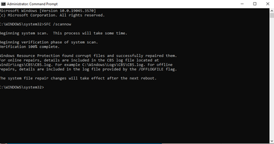

seems I have been able to fix this with running CMD with Admin rights and typing command
SFC /scannowThis is Windows tool to repair when some Windows functions do not work.
I have got summary after this
Seems good so far, I was able to install STMCubeIDE 1.14.0 and CubeMX 6.10.0
Hopefully it solves the issue finally.

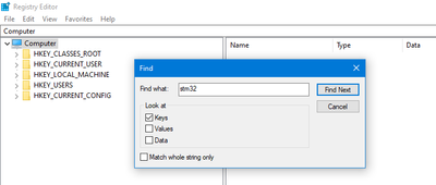

I have double-checked registry looking for any stm32 keyword and this is as follows:
searching conditions
results:
This one can not be deleted:
Any further hints?
Thanks for your support!

now i just tried running this SFC , as shown. after some minutes scanning : " no problems found" . ok.
BUT: STMCubeIDE now starting ! in every workspace... unbelievable !!!
Thanks !!!
