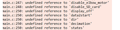

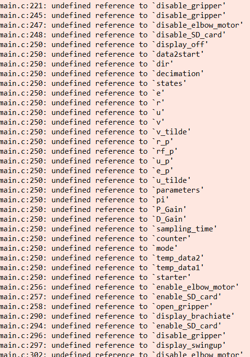

Am working on a code to control a robot and receive data from IMUs on the robot using NUCLEO-L4R5ZI-P. The generated code is proper but am having issues with the with my used code. below is what i have in main.c:

here is the functions.h that defines the variables:

In my understanding, all the variables have been defined. but am still getting the errors on all the data defined in main.h below:
apologies for the long post, but I have tried a lot of fixes to try to clear and have the code build but no luck. Any help is appreciated on how to define these items.
2024-08-29 1:44 AM
The project was shared in private as the user requested.
The issue was solved:
Basically the issue:
All variables were declared in main.h. That file is included in more than location which induced to object multiple definitions.
Fix: all these variables declaration was moved from main.h to function.c file and exported in function.h as extern.

Start with the first error.
I don't see a definition for disable_gripper anywhere. It's declared (not defined) in main.c and in functions.h.
Is there a function.c that defines it? Is that getting compiled?
Similarly, for variables, I don't see a definition for u_tilde anywhere. What file is this defined in and is that file getting compiled?
2024-08-27 4:00 PM - edited 2024-08-27 4:01 PM
Where did you define all these "undefined" objects?
You exported them in function.h but you need somthing like a "function.c" file where these objects need to be defined and function.c to be added to your project.
2024-08-27 4:15 PM - edited 2024-08-27 4:18 PM
Yes, I have a functions.c below that is being compiled.

Why don't your line numbers line up?
The first error complains about disable_gripper on line 221, but line 221 is a comment. It could just be the formatting from the forum, but ...
And why are there so many global variables? It's a style thing, but globals have been considered harmful since 1973.
The definition for disable_gripper is not in the file you posted.
2024-08-28 2:53 AM - edited 2024-08-28 2:53 AM
Ok but I don't see the undefined objects declared in function.c file.
for example "disable_gripper", "decimation" .. etc ..
They were not declared in your function.c!
2024-08-28 2:54 AM
@TDK wrote:The definition for disable_gripper is not in the file you posted.
Neither are any of these:
I didn't check the rest!
The fundamental problem does, indeed, seem to be that you have just declared these things, but not defined them.
https://c-faq.com/decl/decldef.html
2024-08-28 5:16 AM
I did not show them in the main.c, they come after GPIO_Init as below:
