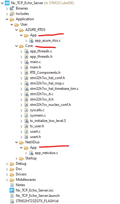

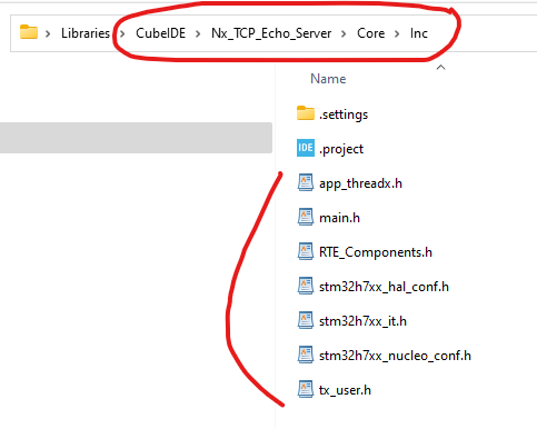

I have imported several example projects into CubeIDE which don't show the header files. The header files do actually exist in the windows file explorer, and the project does properly build and run. So why don't these show up on the CubeIDE (Eclipse) project view? Is there some Eclipse setting that I am missing?

Actually ,in the examples only c-files are shown in the IDE. h-files are not listed. They are only known to the toolchain as include paths. But not visible in the IDE.
This is a known limitations of the example projects.
