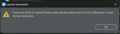

I am trying to start a remote debug session from StmCube IDE Installed on my computer and I get this error.
I haven't encountered this problem before and I don't quite understand its cause because I have configured everything correctly :

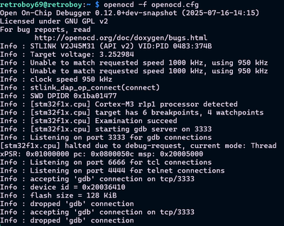

- in Cube IDE Debug Configuration I selected connect to remote GDB Server with correct host name and port 3333.
- in the pi side I created an openocd.cfg file which includes "bindto 0.0.0.0" command in order to allow connections from any ip.

Hello @retroBoy69, and Welcome to ST Community!
Are you using ST-Link or OpenOCD on STM32CubeIDE? If STM32CubeIDE expects an ST-Link GDB server but receives different responses, it may fail to verify the ST device and close the connection.

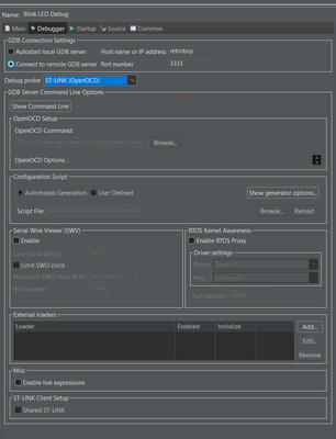

2026-04-06 5:29 AM - last edited on 2026-04-06 8:44 AM by STackPointer64
Hello @STackPointer64, thanks for your reply.
Here is my full Debug Configuration :
Any help will be appreciated.
