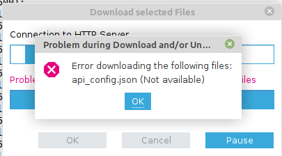

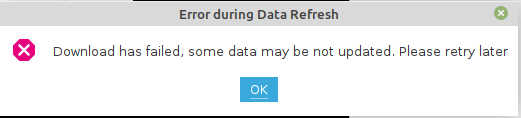

Today, when I try to create a new project from an existing STM32CubeMX configuration file (ioc), I get two errors.
Clicking Ok, CubeIde show the menu for selecting project, and seems like nothing happened.
Can I trust projects created this way?

Hello @xisco
The errors shown are most likely caused by STM32CubeIDE being unable to refresh or download online package metadata.
To resolve them, first make sure CubeIDE can access ST’s online repositories. Check that your internet connection is working properly, and if you are using a proxy, firewall, VPN, antivirus web filter, or a restricted corporate network, verify that these are not blocking CubeIDE’s outbound HTTPS access. If needed, configure the proxy settings correctly in CubeIDE or temporarily disable the network restriction for testing. Once connectivity is confirmed, restart CubeIDE and try creating or regenerating the project again.

Hello @Ghofrane GSOURI
I have no restrictions on my network and the problem persists today.
I uninstalled and reinstalled CubeIDE 1.19.0, but the problem persists.

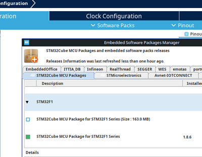

Sorry, my answer was incomplete.
Creating a new project in CubeIDE 1.19.0, I have the same errors, and after clicking Ok, I can access the MCU selection.
I installed CubeMX 6.16.1 and I can access the MCU selection with no errors.
Regards
Are you logged in, in IDE menu... ?
Because if not logged in, I got same error.
Hello, @AScha.3
Yesterday I went to the other town to test it, and I had the same problem.
Now, I'm in my habitual city, and I have no errors.
I've noticed that CubeIDE now doesn't ask me for the password, so the problem is probably what you described.

Hi, @xisco
Go in IDE menu-> Help -> stm32Cube updates -> connection to stm -> enter account ... (accept cookies...)
is your name/pass as here , then you get access ... try.
Maybe need update the software package for the cpu series you want to use , in IDE Cube ->
software -> manage ...
