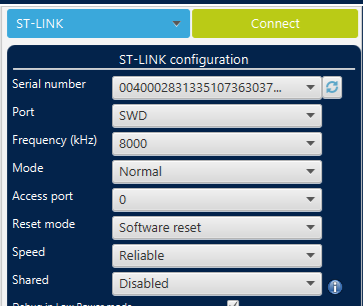

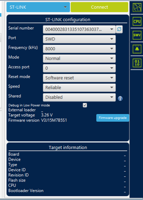

i reboot and my stm32cubeprogrammer looks like this:
as soon as i click sth the connection to st-link is lost is lost
