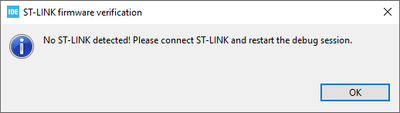

I have a project with a NUCLEO-F767ZI that was working a few days ago and now I can't connect to its ST-Link probe.
I instantly get the message: “No ST-LINK detected!Please connect ST-LINK and restart the debug session.”

2024-07-16 4:59 AM
Please post the full Console output for when you try to start a debug session.
Also screenshot(s) of any error pop-up(s)

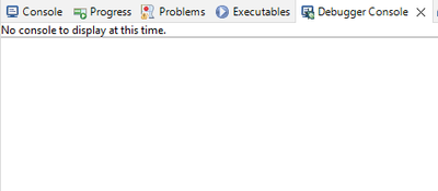

2024-07-16 5:06 AM - edited 2024-07-16 5:07 AM
My Debugger console is empty.
When I click on the debug icon, I just have the following windows who pop instantly.
The last message of my console is just "Build Finished. 0 errors, 0 warnings."
