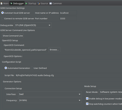

2025-09-15 4:41 AM - edited 2025-09-15 4:43 AM
> While many boards face connection issues with STLINK-V3 in STM32CubeIDE, some boards succeed to be connected.
The IDE checking the cpu is "genuine STM" , so it refuses connect on all cpus that might be not from STM.
CubeProgrammer connects -if possible- also to other ARM cpus.
But here , on (i assume) genuine STM32G474VET6 , it should connect also in IDE .
Maybe try: set debug to using openOCD (i had some strange "no target.." , but switching the debug to OCD - it works. And even switching back the debug setting, it works. This happened also on boards, working before....and then also working again. So dont ask me "why" .)
so try: (and adjust the settings...see:)
2025-09-15 8:28 PM
