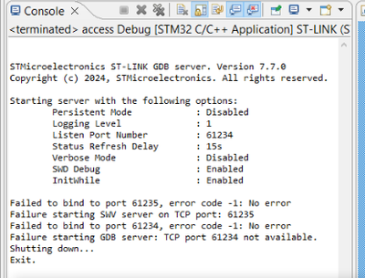

So same issue as here: https://community.st.com/t5/stm32cubeide-mcus/st-link-error-failed-to-bind-to-port-61235-failure-starting-swv/m-p/784642 ?
Did you not get any error messages like that one?
