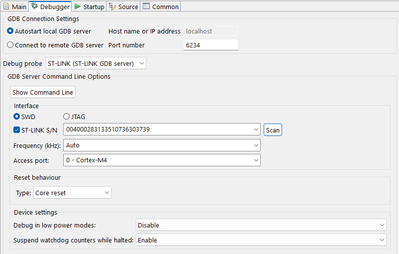

starting with Update 1.18 (update from 1.17) sth. broke and i cannot debug anymore.
I tried a nucleo Board with integrated St-Link and an ST-Link V3. All Screenshots were done with the v3 St-Link
I reinstalled CubeIDE already from the complete download-package, but still the same problem
i always get
But the update works ( so my st-link is found)
I can flash my image via st-link utility without problems.
but cannot get debug to work with 1.18.
With v1.17 i had no problems at all and debugging worked flawlessly.
So what can i do to fix this?

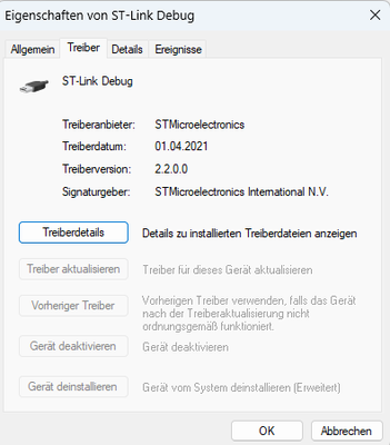

2025-03-18 8:10 AM
this is what my device manager shows me. it is an st-link v3 but with the nucleo st-link v2 it is also not working :(

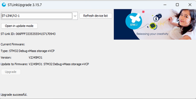

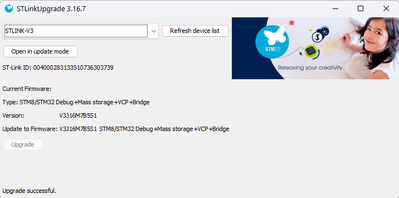

in the cubeprogrammer: when i try to upgrade my st-link it wants to downgrade the firmware.
this is the version i get via cubeprogrammer
and via stm32cubeide

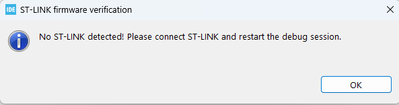

what i noticed: cubeIDE does not even try to start GDBServer. it performas a prelaunch check and then the message box with "No St-Link connected..." appears
2025-03-20 7:35 AM
Well, that makes sense - if it can't find any ST-Link, then there's no point in it starting a GDB server.
