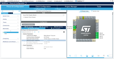

2023-11-09 9:09 PM
For some reason, I can't upload my IOC here. In the IOC file, first I set up the HSE PLL clock with 16MHz crystal and 72MHz system clock. Then I set the I2S2 to full-duplex master mode, communication standard is I2S Philip, Data and Frame format is 16 bits data on 16 bits frame, 44KHz audio freq. When turning on Master clock output or changing to 24 bits data on 32-bit frame, I get the error message saying 8MHz is too low.

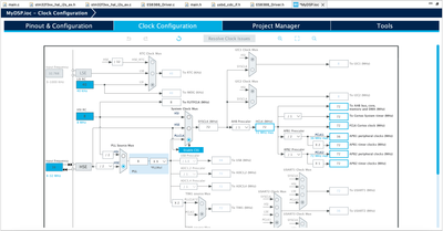

Hi.
I also think that's a bug. Because I set up the system clock to 72MHz first, then set up the I2S later.

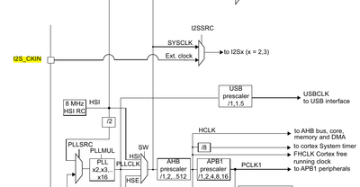

2023-11-10 12:42 AM - edited 2023-11-10 12:50 AM
to put in i2s external clock, >48 pin case is needed...
PC9 is not here, in 48pin case. so we cannot use/switch to i2s_ckin.
but internal clock should not be 8M !
clock tree from ds :
so I2S clk should come from sysclk (72M) , not be 8M (...HSI RC is 8M ??)
who is wrong here ? Cube or datasheet ?

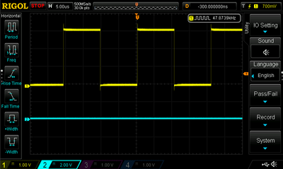

2023-11-10 7:25 AM - edited 2023-11-11 12:08 AM
now i tried with a real F303 , to see what its doing real:
first set it to I2S , 48khz (wished) , no i2s_mco:
and 47,873KHz coming out. :) :)
(72MHz / 1504 = 47,87234 kHz --- we need @Piranha to find the mathe , how to get "50.0kHz real" here )

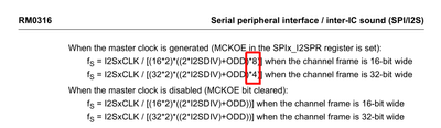

next: switch on mco (in debug->periph.registers MCKOE called here) -> FS now 5,9842kHz !
so DIV 1/8 switched in.
i couldnt find this behavior in manual... the secrets of STM , maybe.
ed. Jan found it ... :)
so its no basic error in Cube, the clock is divided by 8 , as soon as mco on.
simply said: unusable at > 8kHz and standard audio FS, with audio dacs, that need a master-clk.
with i2s-mco ON , max FS is 70..kHz.
next possible with direct register setting and mco:
70,314 kHzwith I2SPR at 0x202 mco then 18,00 MHz
56,252 with I2SPR at 0x302
46,8766kHz with I2SPR at 0x203
40,18kHz with I2SPR at 0x303
(real setting here: 72MHz /7 (=mco)/256 (= FS) = 40,1786 kHz)
so just this IS possible.
2023-11-10 11:36 PM
As I've said above, if your goal is to have a particular audio frequency, you *start* with selecting an appropriate crystal, rather than trying to fit a integer-multiple-of-1MHz onto the desired audio frequency.
That CubeMX can't calculate is another thing. Just don't use it.
