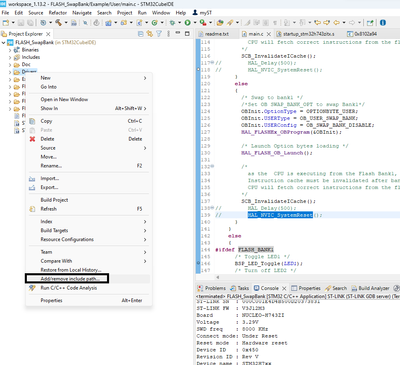

I'm using the NUCLEO-H753ZI, with the STM32CubeIDE development tool (Version: 1.13.0, Build: 7399_20230707_0829 (UTC)).
While trying to build the project - I'm countering the "No such file or directory" error even though the path is included!! see attached pictures.

2023-11-12 6:18 AM
Solved the problem by including path - using the "Add/remove include path..." option:
