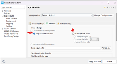

Apologies for jumping in - where is the command line > 32K chars/bytes? The command that failed with error 87 does not exceed 32K, it is much less. The error likely is thrown by Windows API CreateProcessW and may be caused by the "..." parameters not printed in the log.
Linux or Mac obviously do not have this error because there is no CreateProcess().
For a quick trial:
1. please reproduce without the make -j option, to simplify the situation and logs. Will the same command fail again, with the same error?
2. Try internal builder instead of external

1. Where should I put the -j option in CubeIDE?
2. I'll try it when I get a chance.
