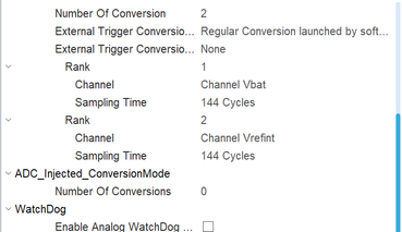

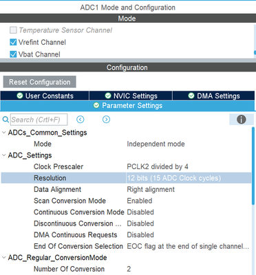

I'm trying to use the ADC to measure the Vbat voltage on my STM32F401RCT6 but i get some strange values. Here is my setup in the device configuration tool:

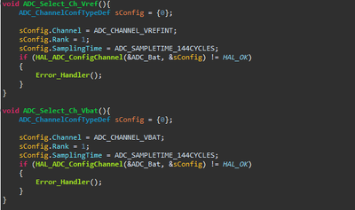

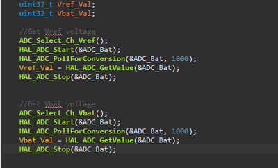

And here is the code with the returned values:
Vref_Val = 303
Vbat_Val = 932
I have connected a CR1220 battery, but the Vref value seems to be really small for a 12 bits ADC value. I'm pretty new to STM so if anyone could help me thats would be great.

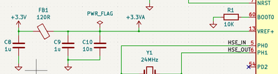

I just measured Vbat and its 3V hooked up to the STM32. But yeah you've explained it way better than me. I have this ferrite bead hooked up to the Vref+ pin. Might that be a problem? I dont think so since it has a resistance of 120 Ohm @ 100MHz
