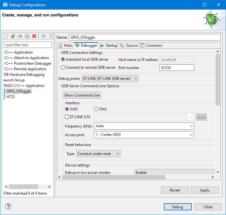

I'm not sure this is your problem, but the STM32H5 needs to communicate via Access Port 1, make sure this is correct in the Run/Debug settings.
It is a common misconfiguration when using H5.
The STM32CubeProgrammer switches automatically to Access Port 1, but I'm not sure for STM32CubeIDE.
For the H723 board, I have no clue.
2023-12-11 7:51 AM
Yes the IDE selected the access port 1:
It's the only choice.

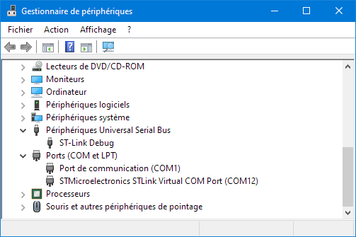

How I check if STLinkServer and STLink usb drivers are installed?
Il did the standard CubeIDE install.
The device manager shows:
The CubeIDE V1.14.0 required the STLINK firmware upgrade to:
Version: V3J13M4
Build: Jun 16 2023 16:43:25I think the USB cable is OK because I use it for a long time, and CubeProgrammer works flawlessly with it.
Do CubeIDE and CubeProgrammer use different drivers?

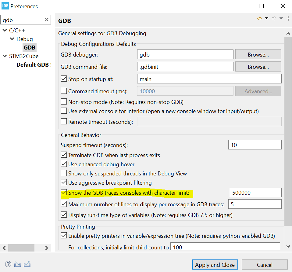

Could you also enable the GDB server traces to get more information, that would be helpful.
