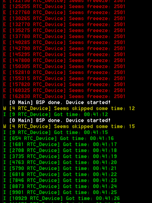

Hah, funky. I thought I had bug in code for H7. Started writing my function from scratch and found out that getting time with HAL lib actually freezes getting time. What is funny I cam across this problem back from 2y ago. Despite that good to have HAL as startign point.
Here effect before and after fix:
2023-12-18 7:42 AM
Actually seems I was wrong. I started getting some otther errors related to calendar. The I found comment:
" * @note You must call HAL_RTC_GetDate() after HAL_RTC_GetTime() to unlock the values
* in the higher-order calendar shadow registers to ensure consistency between the time and date values.
* Reading RTC current time locks the values in calendar shadow registers until Current date is read."
Finally it works as expected:
