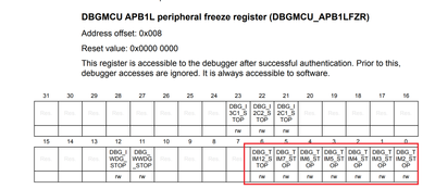

STackPointer64
It is not available in MX2. It needs to be configured manually in the debug register, DBGMCU_APB1LFZR, in particular. I invite you to check the reference manual, page 2543.

STackPointer64

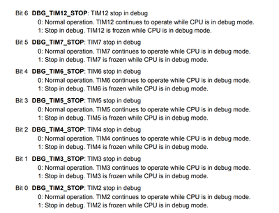

mƎALLEm
You need to use DBGMCU block and call call __HAL_DBGMCU_FREEZE_TIMx() to freeze the timer during the debug.
If you re using TIM1 so call  __HAL_DBGMCU_FREEZE_TIM1().
DBGMCU_APBxy register:
