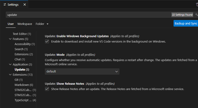

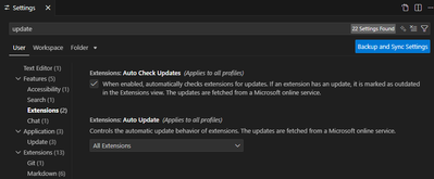

Thank you for your question. We take care to address your concerns. We aim to serve all users, not only hobbyists.

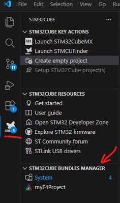

The STM32CubeIDE for Visual Studio Code solution consists of three main components:
You should be able to maintain full control.
At a high level, we recommend keeping VS Code extensions and bundles up to date.
That said, despite taking great care, not updating extensions can be risky because some depend on each other. VS Code itself improves over time.
Locking bundles is fairly safe and more meaningful to us, which is why we provide this bundle locking capability. The rationale is that bundles support core processing; we are fully aware that toolchain updates may impact end-user applications.
VS Code extensions mainly support the GUI, which may not impact results but affect the user experience.

Note: You can freeze and stay online. The proper settings shared above are capable of this.
