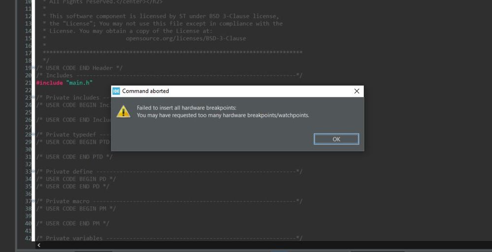

When I try to upload to my STM32G030F6P6 I get the following error and sometimes I get the "Command Aborted" message attached in the picture.
I tried resetting my workspace too. But still I get this error.

2021-11-19 5:24 AM
Can you select Run -> Remove All Breakpoints or is it grayed out? If you can, does it resolve the issue?
2021-11-19 5:46 AM
It is grayed out :(
I am just setting the Serial Wire in the configurator and uploading the generated code. There isn't even a single line I typed
