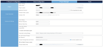

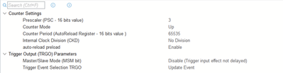

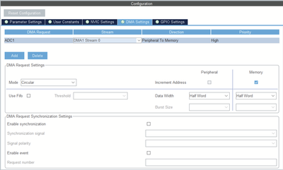

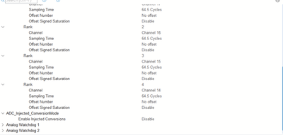

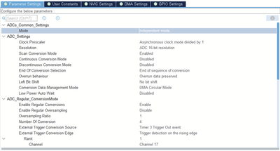

I've followed this great guide (https://www.youtube.com/watch?v=_K3GvQkyarg), and I've attached screenshots of peripheral configuration:
My APB1 Timer bus is being run at 264MHz and my ADCs are being fed 150MHz clock. Timer 3 should be converting at a rate of roughly 1kHz, to which I do not suspect to be an issue with DMA bandwidth at all.

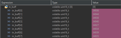

I do absolutely agree now that this is some issue with my VSCODE configuration. I tested this by taking the .ioc file, copying it into a new directory, and creating a cubeIDE project from it directly. I also copied the EXACT same main.c file and ran code generation with it. In my live expressions on VSCODE, I see absolutely no activity, but on the mirrored cubeIDE project I just made again, it works perfectly.
I should also say that this is not neccessarily an issue with the VSCODE live expressions viewer, as I've configured my launch.json file correctly and it works for any other dummy expression I test. See below:
CubeIDE live expressions:
VSCODE:
