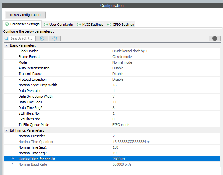

static void MX_FDCAN1_Init(void)
/* USER CODE BEGIN FDCAN1_Init 0 */
/* USER CODE END FDCAN1_Init 0 */
/* USER CODE BEGIN FDCAN1_Init 1 */
/* USER CODE END FDCAN1_Init 1 */
hfdcan1.Instance = FDCAN1;
hfdcan1.Init.ClockDivider = FDCAN_CLOCK_DIV1;
hfdcan1.Init.FrameFormat = FDCAN_FRAME_CLASSIC;
hfdcan1.Init.Mode = FDCAN_MODE_NORMAL;
hfdcan1.Init.AutoRetransmission = DISABLE;
hfdcan1.Init.TransmitPause = DISABLE;
hfdcan1.Init.ProtocolException = DISABLE;
hfdcan1.Init.NominalPrescaler = 2;
hfdcan1.Init.NominalSyncJumpWidth = 16;
hfdcan1.Init.NominalTimeSeg1 = 130;
hfdcan1.Init.NominalTimeSeg2 = 19;
hfdcan1.Init.DataPrescaler = 4;
hfdcan1.Init.DataSyncJumpWidth = 8;
hfdcan1.Init.DataTimeSeg1 = 11;
hfdcan1.Init.DataTimeSeg2 = 8;
hfdcan1.Init.StdFiltersNbr = 1;
hfdcan1.Init.ExtFiltersNbr = 0;
hfdcan1.Init.TxFifoQueueMode = FDCAN_TX_FIFO_OPERATION;
if (HAL_FDCAN_Init(&hfdcan1) != HAL_OK)
Error_Handler();

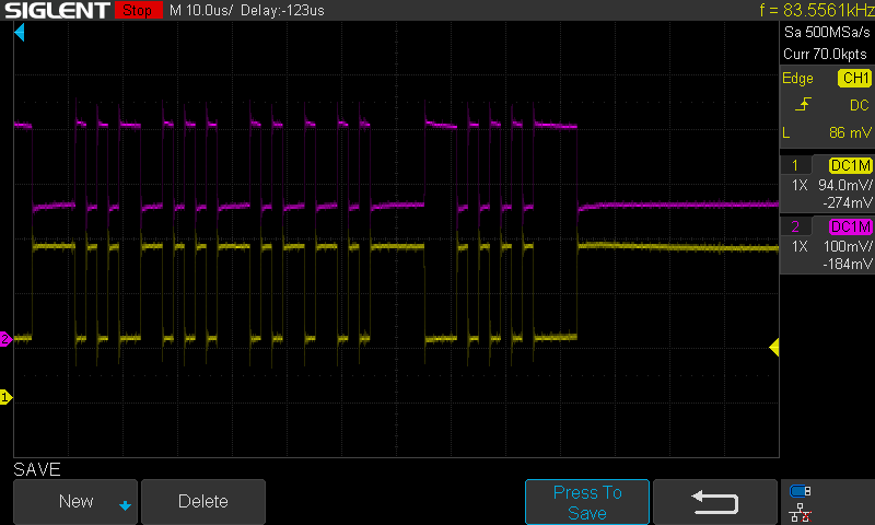

}Oscilloscope reading on the CANH CANL linesI have gone through posts (Link1, Link 2) who had similar issues, and I'm not facing that issue. My Std Filters Nbr=1 and Interrupt is enabled.
