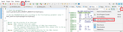

2024-06-20 2:34 AM - edited 2024-06-20 2:43 AM
this seems working on my side:
