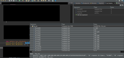

After updating to STM32CubeIDE Version: 1.18.0 Build: 24413_20250227_1633 (UTC) the live expressions completely broke
All the variables now show 0 and they won't vary
As you can see from the screenshot, hovering while on breakpoint shows the correct value. On the top right, all the values are 0 in the live expressions tab

The issue seemed to be the GDB server.
Switching to OpenOCD has made the live viewer during debug work correctly

Hello @nico23
I am unable to reproduce the issue on my side. Could you try these suggestions below and check if the issue persists?
- Update the firmware version of ST-Link.
- Disable optimization during debugging by compiling with -OO
- Debug with OpenOCD if you are using a GDB server.

It happens with OpenOCD as well.
The issue is ongoing and never fixed, as seen https://community.st.com/t5/stm32cubeide-mcus/live-expressions-bug/m-p/647393#M24955 https://community.st.com/t5/stm32cubeide-mcus/a-big-problem-with-live-expression-values-shifted-down/td-p/703729
The only workaround seems to be
Step 1) Close the Tab of the Live Expressions.
Step 2) Right Click on Project >> Select "Clean Project"
Step 3) Build and debug
Step 4) Select the "Live Expression" from the windows tab
