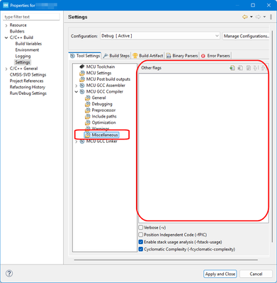

You can add flags in the Project settings Properties here:

Project Settings, name it better "Project Properties" - hard to find. Rightclick on the project in the tree view.
Click on Properties. The one finds C/C++ Build.
It's not in the Preferences menu item (macOS)

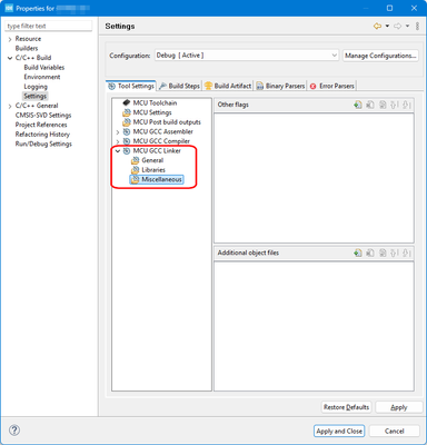

2025-04-08 1:18 AM - edited 2025-04-08 1:34 AM
Ah, it's a linker flag. OTOH, it's passed to gcc -o . Maybe the syntax is still wrong?
arm-none-eabi-gcc: error: unrecognized command-line option '--no-warn-rwx-segments'

2025-04-08 1:57 AM
and was that as a Linker option, or a Compiler option ?
To pass options to the Linker via the Compiler: https://gcc.gnu.org/onlinedocs/gcc/Link-Options.html#index-Wl
