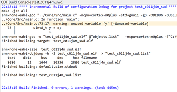

Here is a snippet (I cut out a few hundred lines from the middle) of the console output with the missing 'stdio.h' include triggering the error:

../Submodules/TinyPrintf/printf.c: In function '_out_char':
../Submodules/TinyPrintf/printf.c:155:11: error: implicit declaration of function 'putchar' [-Wimplicit-function-declaration]
155 | putchar(character);//_putchar(character);
../Submodules/TinyPrintf/printf.c:120:1: note: include '<stdio.h>' or provide a declaration of 'putchar'
119 | #include <float.h>
+++ |+#include <stdio.h>
120 | #endif
make: *** [Submodules/TinyPrintf/subdir.mk:19: Submodules/TinyPrintf/printf.o] Error 1
make: *** Waiting for unfinished jobs....
"make -j6 all" terminated with exit code 2. Build might be incomplete.
