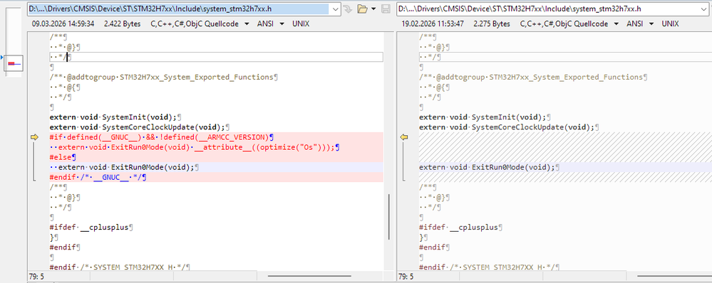

[build] 1 warning generated. Comparing the versions of system_stm32h7xx.h shows following:
We use the "CMake" and "ST Arm Clang" settings in STM32CubeMX
under "Project Manager / Project / Default Compiler / Linker".
After generating the project we open the folder with VSCode with active STM32CubeIDE Extension.
But clang can not work with the new __attribute__((optimize("Os")) but defines the __GNUC__ macro for compatibility reasons. Therefore we get a warning.
@st Please solve this issue - Thanks
Bet regards Timo

Since clang by default pretends to be GCC and defines __GNUC__ ...
#if defined(__GNUC__) && __has_attribute(optimize)
Thanks.

The optimize attribute is a GNU attribute and is not supported by Clang.
However, in system_stm32h7xx.h, the check for using this attribute is based on __ARMCC_VERSION, which is defined only for ARM compilers. Waiting for a fix you could also insert this check: !defined(__clang__).

Proposed a fix via github issue, against cmsis-device-h7 release 1.10.7 here.
Use the standard preprocessor function __has_attribute rather than check for specific compilers.
